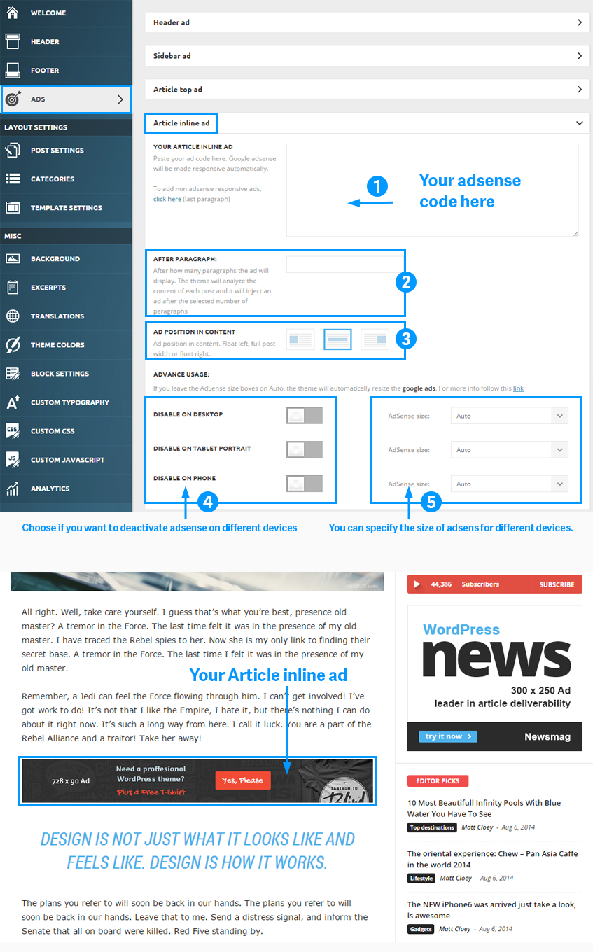

how to set 728 x 90px ads in article inline ads, because i see in ads full guide you can add 728 x 90px ads in article.
https://forum.tagdiv.com/ads-system-full-guide/ — section “Article inline ad”
i try to use 728 x 90px ads in my article but its not fit because the article content width only about 630px.

I believe what i refer is for Newsmag not for newspaper, as you can see in this link https://forum.tagdiv.com/wp-content/uploads/2014/10/ad-system-inline.png
The link which i refer above is newsmag documentation. Correct me if i’m wrong. There are a section which obviously told me that it is for 728 x 90px.
If it’s not for newsmag purpose then the author must be wronged, maybe they just copy paste ad system newspaper for newsmag. And it definitely not compatible.
