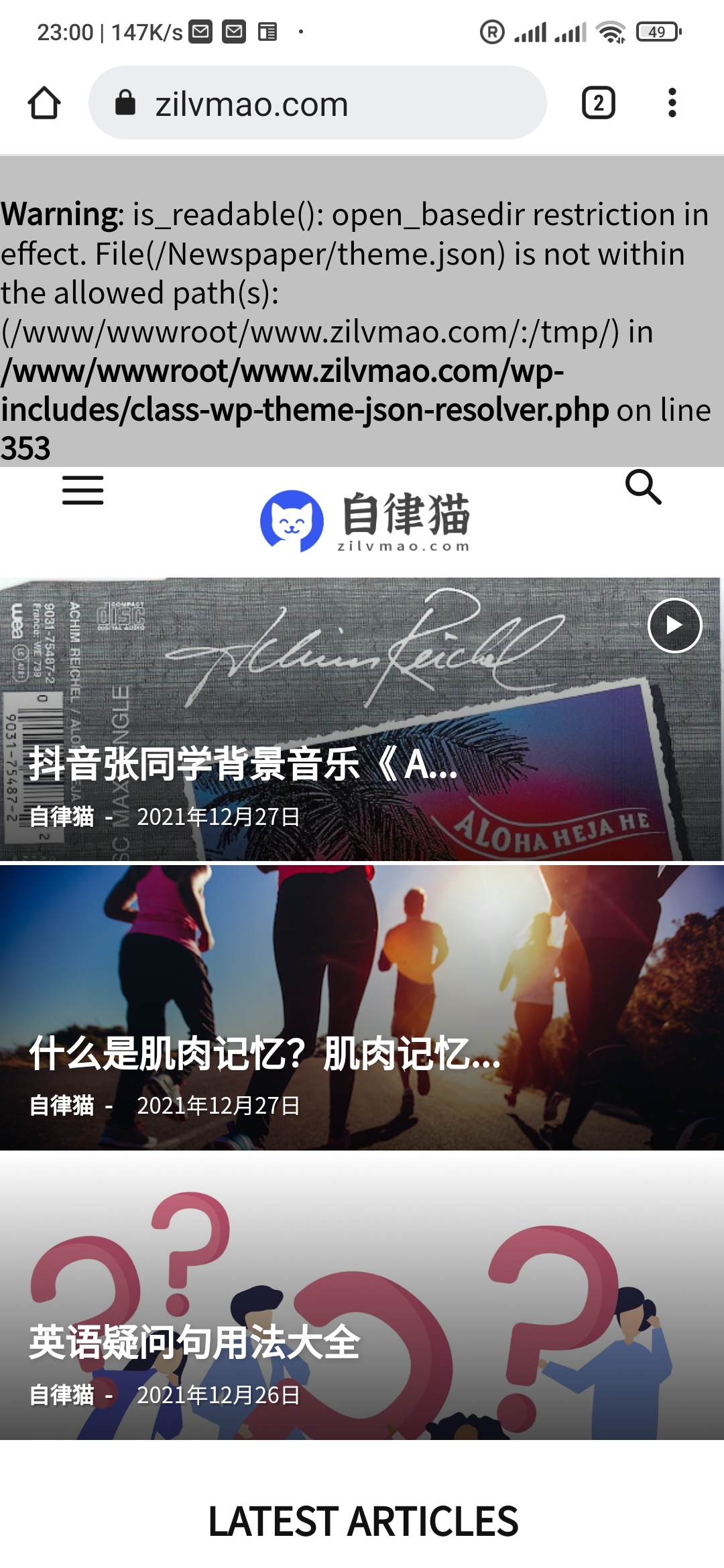

An error code appears at the top of the mobile terminal
Post count: 79
The error code is shown in the figure, please ask for urgent help
Post count: 79
Does anyone know how to fix it? As soon as I install the mobile theme plugin and AMP plugin, this problem appears

Post count: 79
Thank you very much for your patience, when I deactivate the Mobile Theme plugin, my mobile site works fine.
The ways you recommended is a bit complicated, so I decided not to use AMP for now.

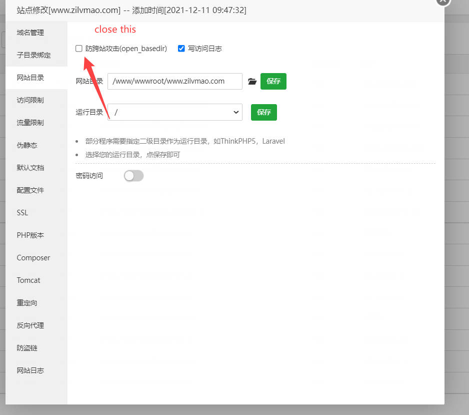

Post count: 79
Hello @Bettina ,
I am happy to tell you that I have found a solution to the problem and the solution comes from this website
https://www.cnblogs.com/feixiablog/articles/9667852.html
In fact, the solution is very simple, go to the pagoda panel, turn off the anti-cross-site attack (open_basedir) and then you’re done
Post count: 79
This solution is generally only available to Chinese users using the BT panel(宝塔面板)
