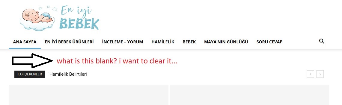

1- https://i.hizliresim.com/k0ZRnr.jpg How can i solve this problem.. i didnt want to use a header template..

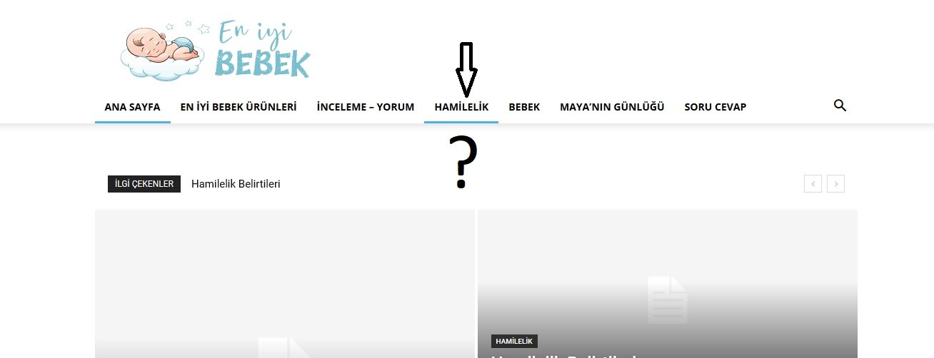

2- https://i.hizliresim.com/NGYJrY.jpg i have a categori which name is “Hamilelik”. and it has got one subcategory which name is “Hafta Hafta Gebelik” . i tried to active preloading or mega menu but it isnt working.. What is the problem?

1. In order to remove the gap you can edit the page and set to the first row a margin top
-40 https://www.screencast.com/t/XHpfT49oE9U ( in you case 48px is the gap so you can set -48 margin top) or you can use custom css -> https://forum.tagdiv.com/create-custom-code-using-the-browsers-inspector/
If you need help whit this please provide a link were I can inspect the problem, in this way I will be able to provide you the right css.
You can change the gap between the elements using tagDiv Composer -> https://www.screencast.com/t/b5rLIcMBxZK
2. You can create a mega menu using our documentation from here -> https://forum.tagdiv.com/mega-menu/
Main menu -> https://forum.tagdiv.com/main-menu/
