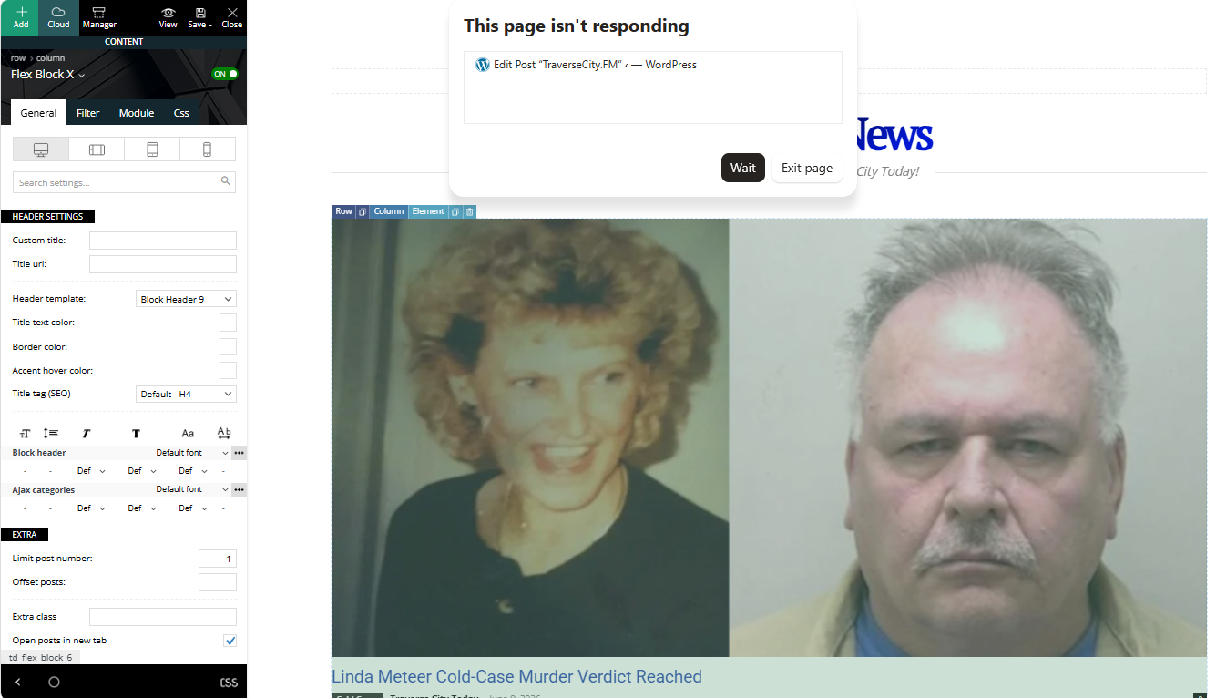

I am experiencing a serious issue with tagDiv Composer on my website using the Newspaper theme. The Composer has gradually become slower over time, and it has now reached a point where it consistently freezes whenever I attempt to add even a single element to a page. The browser eventually displays a “Page Unresponsive” message.

When I add elements with images it freezes every time
