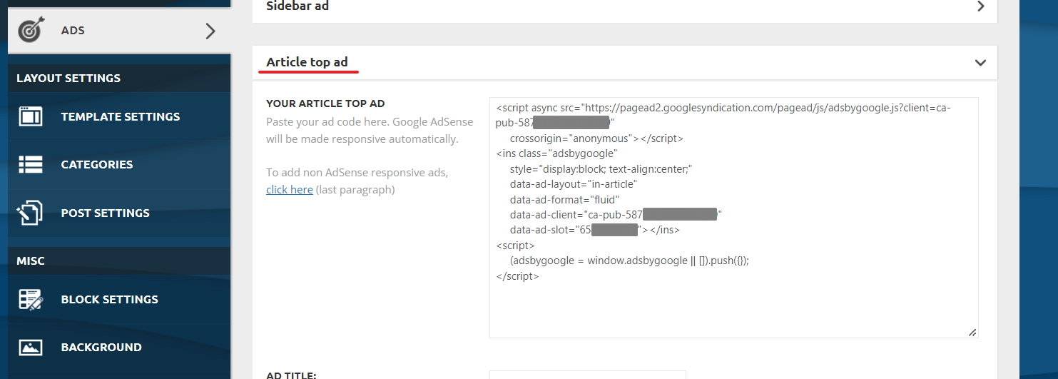

A few days ago, I inserted the Google AdSense ad code into ADS in Thema Panel, but the ads are not displayed on my website.
(If you insert a Google AdSense ad code in the Ad Box element on the frontend, the ads are displayed.)
Could you guess why?
Thank you for your help!
Amie
Post count: 27744
Please edit the Single Post Template with tagdiv Composer.
You can set the ads in Single Post Template from tagDiv Cloud Library and you can set top ad, 3 inline ads set after x paragraphs and bottom ad, please check this article -> https://forum.tagdiv.com/article-ads/ and video https://www.youtube.com/watch?v=biTpVVlr8j8
You can use the element Ad Box, and set the element where you want. The code does not need to be auto ads, so the theme will not have control.
The ad box has 3 sections for ads: using theme panel ads -> https://i.imgur.com/KFa9ibl.png, using images/banners -> https://i.imgur.com/MfAPTaE.png and custom code -> https://i.imgur.com/2rh8SuD.png save it and will appear on the post (you can set a shortcode like a shortcode from adrotate plugin or other plugins).

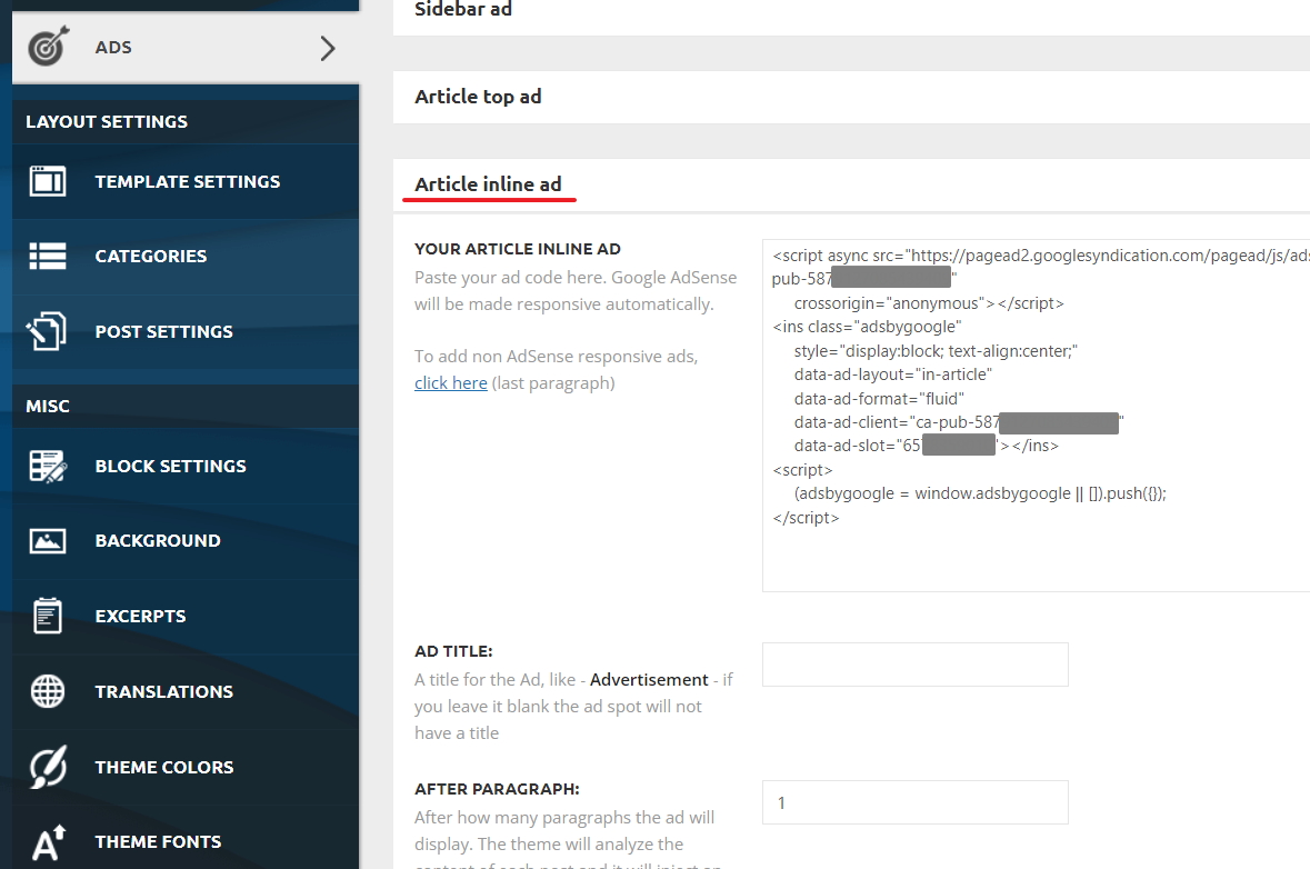

I’m using AdSense and have auto-ads integrated already. But this didn’t show them within the content of the articles (just above and below).
Ah, I see – ad spots in the mobile theme will get used on AMP – but only one article inline ad is not enough, as my content is very lengthy sometimes. So I would need more ad spots within the article content: How can I use more article inline ads for AMP?

Without a dedicated plugin that can add inline ads on AMP, the only solution is to make changes in the theme files.
