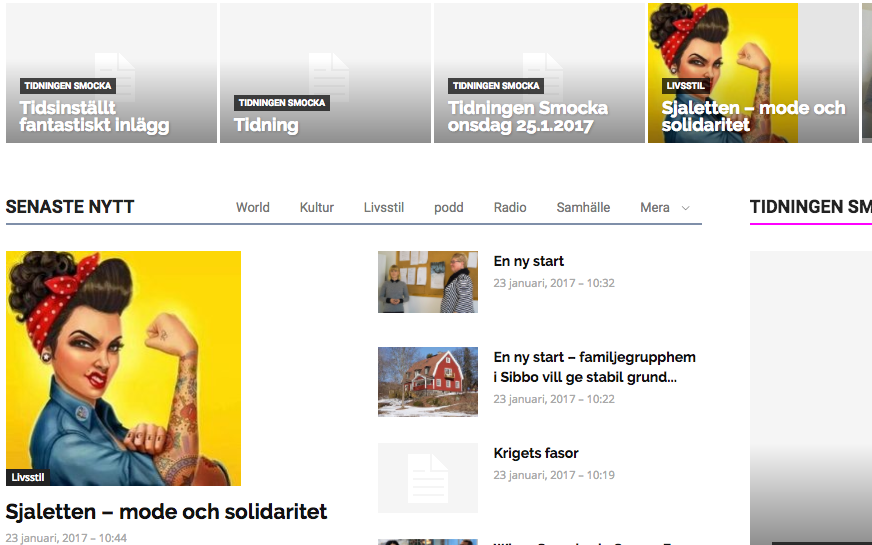

I’ve read the discussion and documents on regenerating thumbnails. I’ve used the tool to regenerate thumbnails without success. My uploaded images are large enough (2000px width), but still, depending on which bLock or Big Grid module, the pictures get grey bars in different modules.
example of big grid: http://smocka.fi/wp-content/uploads/2017/02/Screen-Shot-2017-02-06-at-11.14.34.png
These images are uploaded with widths of 2048 (http://smocka.fi/wp-content/uploads/2017/02/29180864370_5656e4cdec_k-1.jpg, http://smocka.fi/wp-content/uploads/2017/02/30704050895_a54f481393_k.jpg) and 1100 (http://smocka.fi/wp-content/uploads/2017/02/Smocka-kesatyo.jpg). WHy do the images not crop correctly in all big grids or blocks?
The site is now live at smocka.fi if you want to have a look.
Since there are so many thumbnail options, cropping a picture correctly for one certain big grid size manually is not an option since the aspect ratios change between modules.
I’m quite sure the theme is not supposed to work like this. Is there some setting for thumbnails that i might have missed?

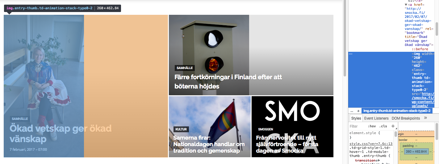

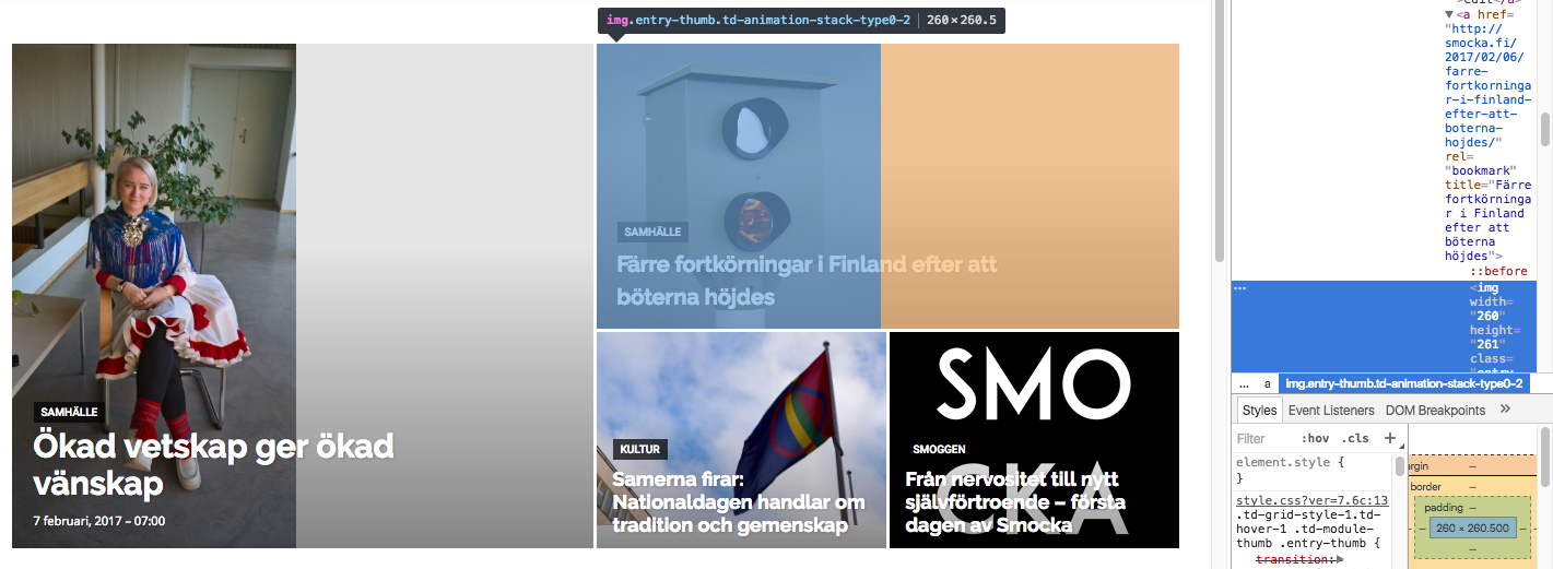

thanks Chris, i now tried this plugin as it was suggested in many threads. I installed the plugin and regenerated thumbnails, but did not solve this issue. Probably because the images loaded were large enough, but they scale wrongly inside the boxes.
Example: here this behaviour, which in this example only happens at viewport > 1140px. The pictures scale as they should on widths below this.
Both images in these boxes get width=”260px” written directly into the img-tag as properties. Don’t know if that is the issue (this also happens at the lower viewports where the layout works). However, the images that actually are loaded into the big grid are of widths 1400px (the one to the left) and 1022 px (the one to top right), i.e. large enough to fill the space if they were cropped to fit.
I’m trying to add “width 100%” or height “100%” at different places in css but this seems only to stretch images rather than crop them so this is not the solution.
I’m really puzzled why the center-top cropping that is described in some earlier threads is not taking place here?
