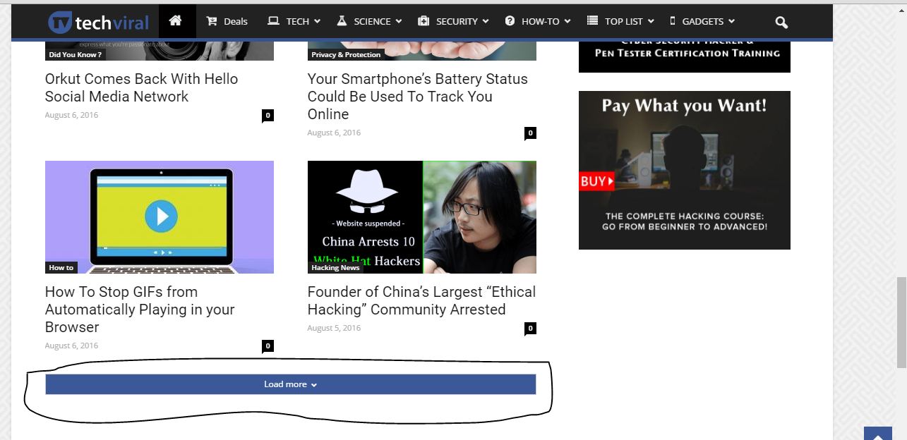

Not this type I want, I want to add like this!
This Image Example
Post count: 23312
Hello Gadgetsay,
You will have to add and this code to your CSS above in order to achieve as you wish.
The code is ->
.td-load-more-wrap a {
width: 696px;
In the future, if you want to customize your website you will have to create yourself the custom CSS code for achieving as you like because all of these processes are custom made and involve additional customizations. A very useful tutorial you should find here -> https://forum.tagdiv.com/create-custom-code-using-the-browsers-inspector/
