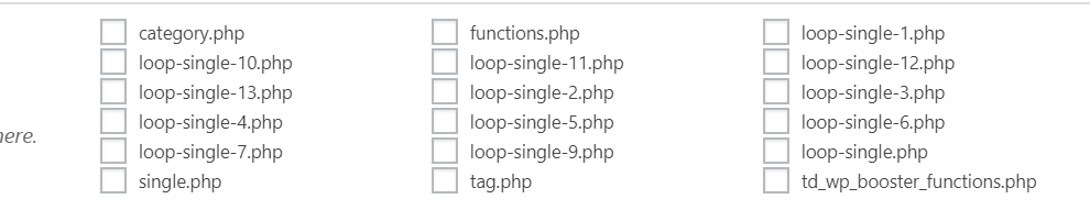

The problem what I have currently is how I can manually edit those files:
chlidtheme
I manually implemented Ratings plugin into my website in every loop-single files:

That would be the case, the child theme is quite limited after the recent update. Most theme files have been moved in the composer plugin as mentioned here
– https://tagdiv.com/updating-the-core-of-tagdiv-themes/
So now the post template files are now in the composer – http://prntscr.com/ng3e26
You could edit them there, but the modification will have to made again after each update.

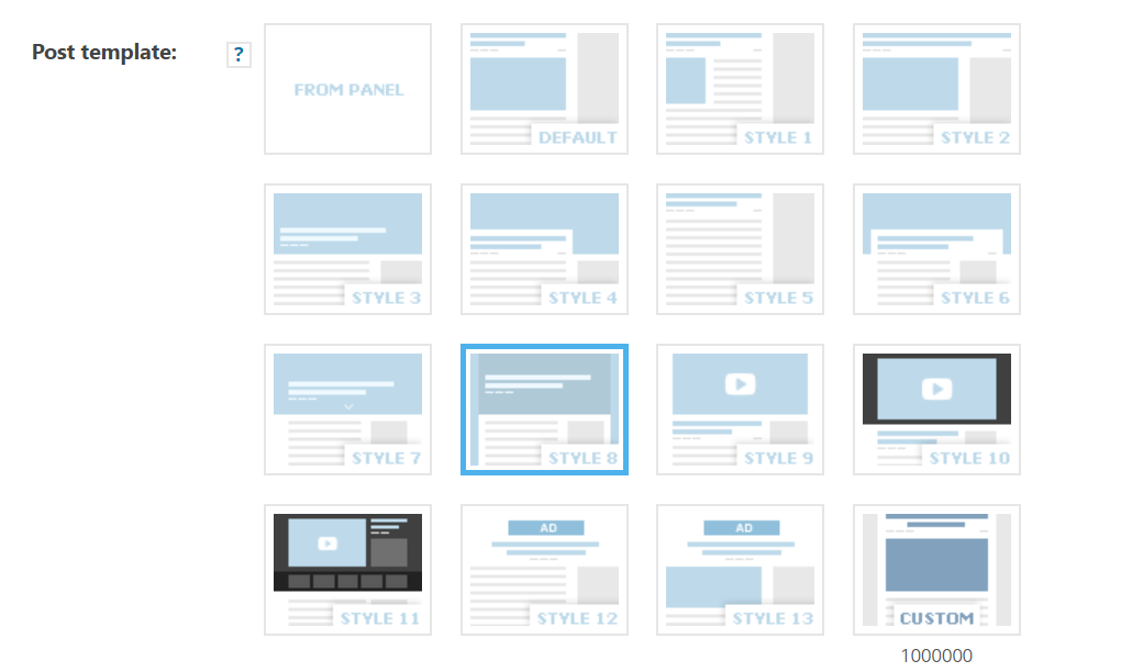

Thanks Simion C, it seems that cloud post template could be an option. So, how and in which place I can edit default templates:

You can edit edit the cloud templates, not the default templates. These are cloud templates made by us, they can be imported through the cloud library plugin
https://cloud.tagdiv.com/#/load/Single
Also you can create your own post templates, starting with a blank template.

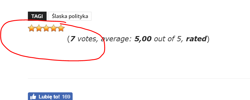

Yep, “Column text”. But for me looks like temporary solution. For example CSS doesn’t work well in this case:

@Tuudi Try a CSS like this to position the rating stars better – http://prntscr.com/ngpko2
.post-ratings img {
display: inline;
margin-bottom: -2px;
Should work, that plugin has a shortcode implementation from what I can see. I believe this is the one – https://wordpress.org/plugins/wp-postratings/
@MKJ
Would be the same for you if you use the same plugin. Seems to work for Tuudi. If it doesn’t work for you maybe it’s a plugin configuration issue.
Post count: 21
@Simion C., your solution works perfectly fine! Thanks a lot 🙂
