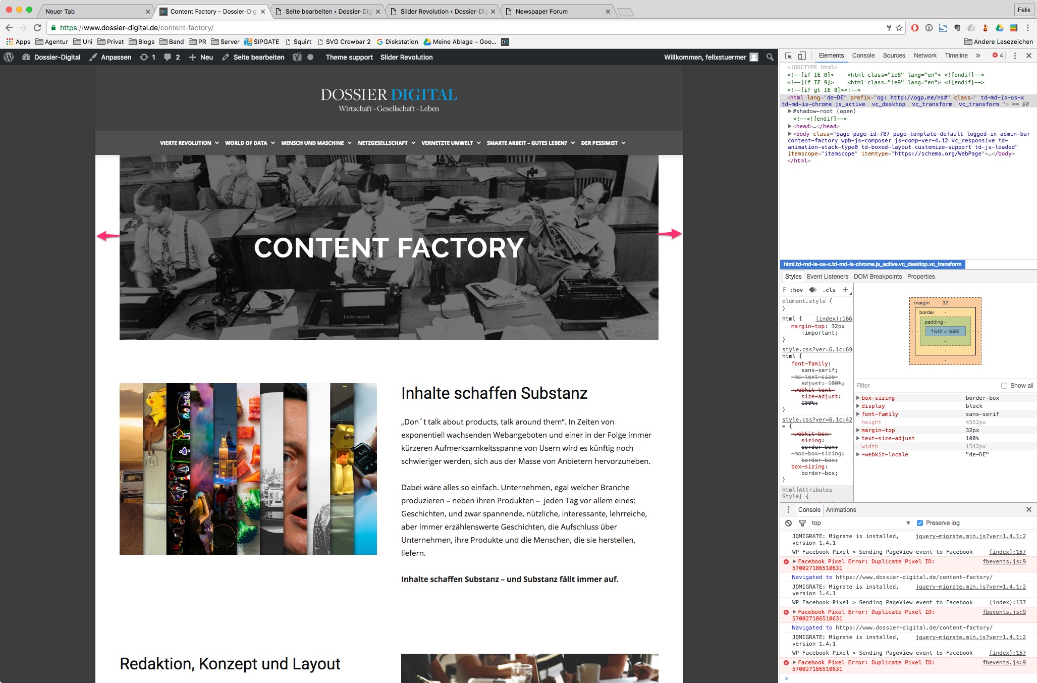

In the old version it was possible:
https://edit.dossier-digital.de/content-factory/
In new one it is not? So what did you change and what can i do in order to get this back?
The same for the revslider part all built with visual composer!
I forget in all previous posts to mention that the important thing is based on Visual Composer!
This reply was modified 10 years by
medienstuermer.

Is there any solution to paste a visual composer row and it’s elements that it’s enabled with full width presentation to the 1164px of your default layout?
Hello medienstuermer,
Please keep in mind that the theme code has changed a lot from the 6 version to 7, together with the Visual Composer code and that’s why appears this difference regarding on Revolution Slider implementation. Another alternative for you would be to set a stretch row and content from Visual Composer and then you will have to apply the overflow:hidden rule for #td-outer-wrap. This is just a quick solution in this regard.
.home #td-outer-wrap{
overflow:hidden;
