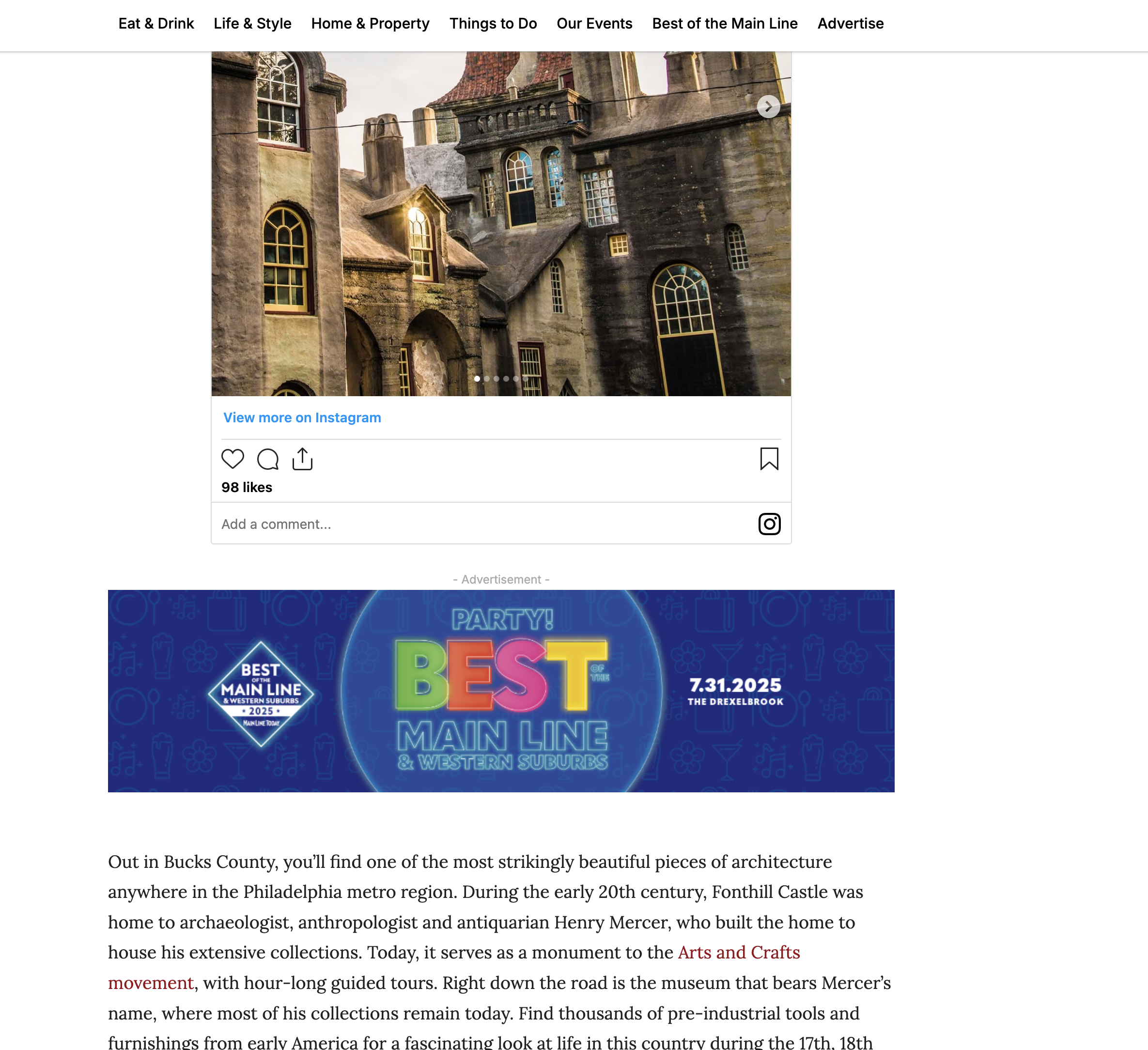

1. How the ad appears when using the Classic Editor.

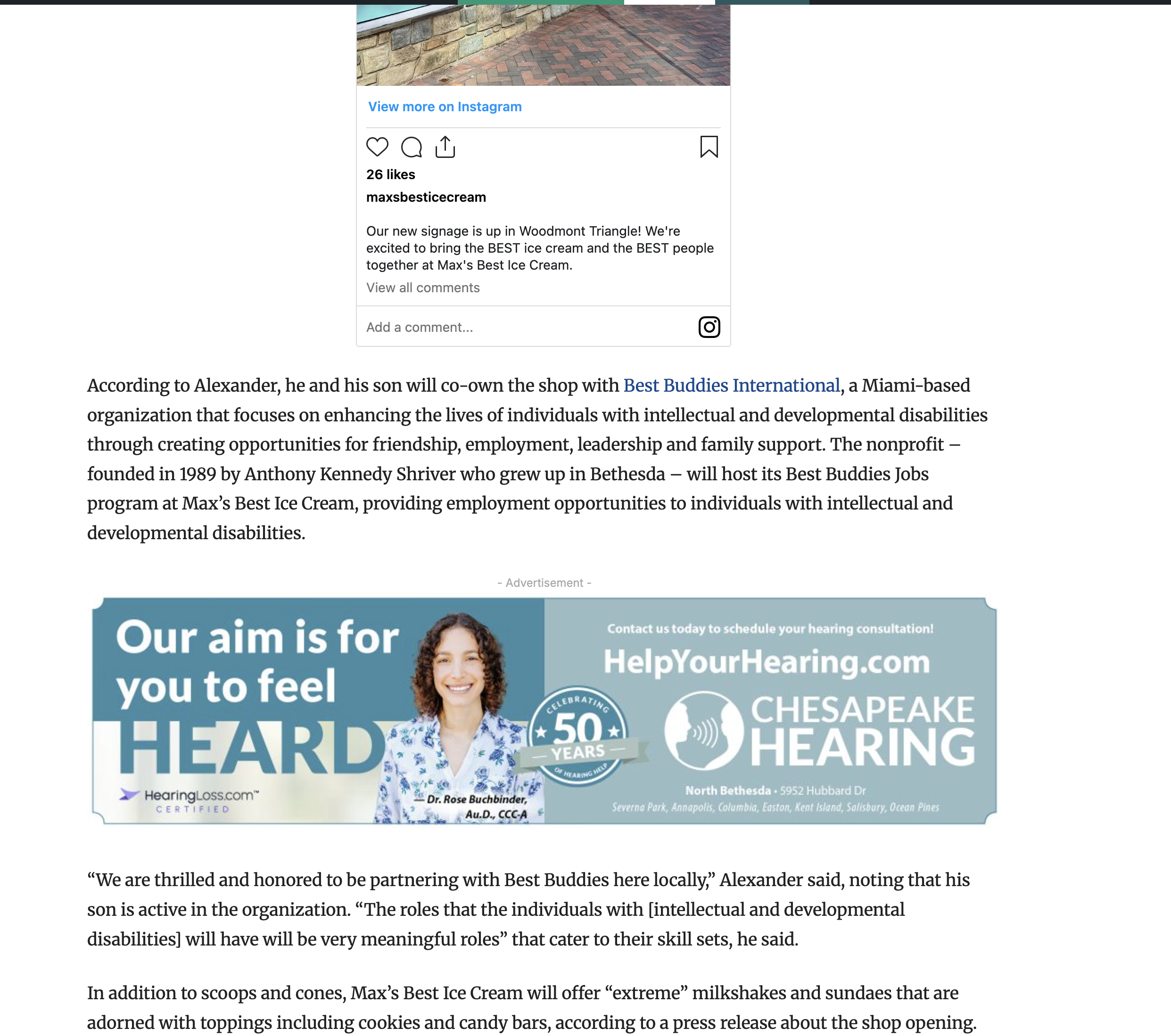

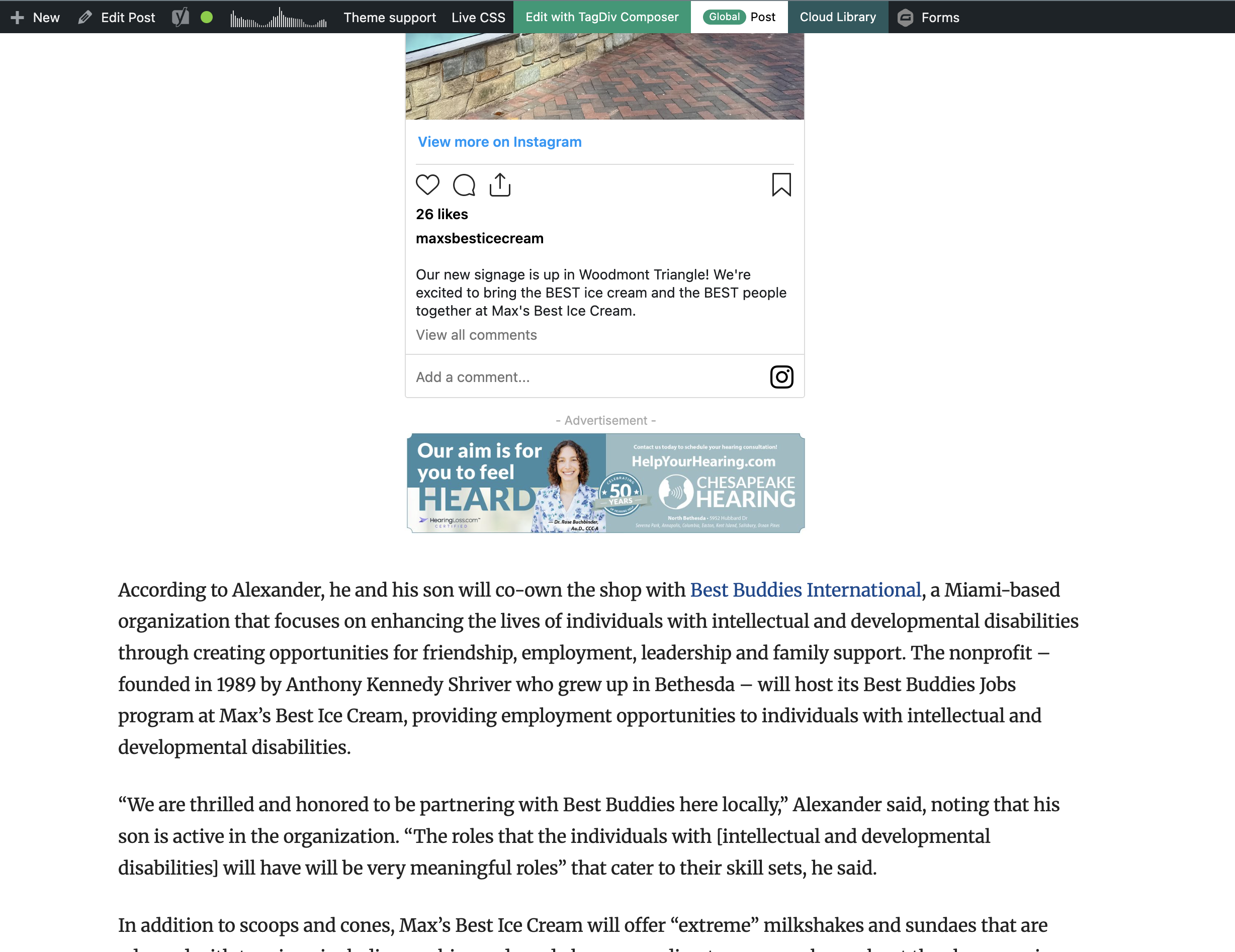

2. How the ad appears when using the Block Editor.
3. How the ad is supposed to look when I adjusted the position from 3 paragraphs to 4 to prevent it from being placed directly after an Instagram embed.

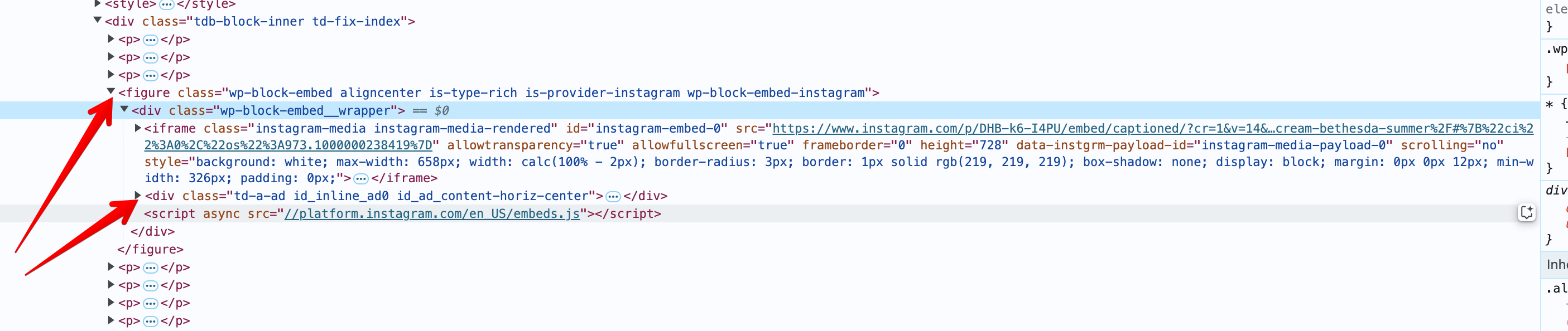

4. The source code showing how the ad is being injected into the <figure> container for clarity.
I suspect this issue may be related to how the theme determines paragraph count and what qualifies as a paragraph. It seems that when using the Block Editor, <figure> elements are not being treated as block elements/paragraphs.
