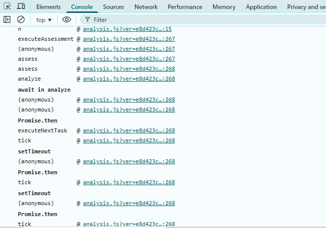

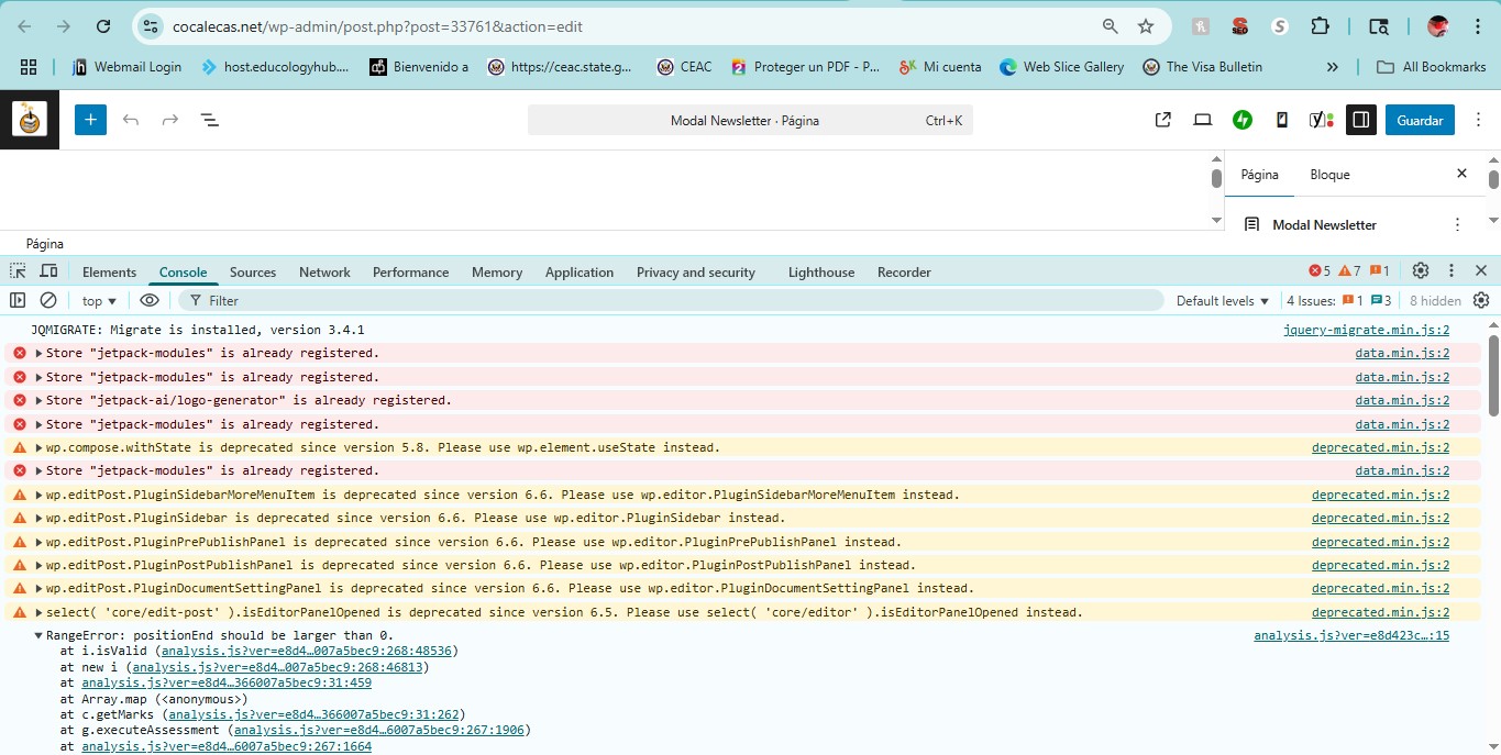

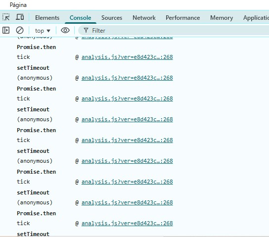

I’ve noticed that the page keeps disconnecting and takes a long time to reconnect. I’ve managed to catch errors in the inspect element in case it helps.
https://cocalecas.net/wp-content/uploads/2025/06/Screenshot-2025-06-04-151450.jpg
https://cocalecas.net/wp-content/uploads/2025/06/Screenshot-2025-06-04-151511.jpg
https://cocalecas.net/wp-content/uploads/2025/06/Screenshot-2025-06-04-151529.jpg
Thanks

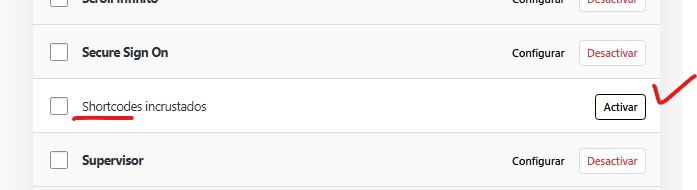

If I’m right this is a know situation with the jetpack plugin – https://wordpress.stackexchange.com/questions/101933/visual-editor-not-working-when-jetpack-plugin-is-active
What you can do s to disable the plugin and check if the problem persist, if is back to normal you can enabled back the plugin and try to disable only the option for Jetpack module (go to wp-admin/admin.php?page=jetpack_modules disable Shortcode Embeds model this will work).
Ok thank for respondme.
now
I have deactivated the module
https://cocalecas.net/wp-content/uploads/2025/06/Screenshot-2025-06-05-101343.jpg
Now, wait. Thanks
