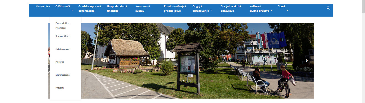

yes now it works
but I need it to be verticaly center aligned… and I noticed that the submenu is also now breaked into two rows, but that I need to be as it was, not like this…
https://i.postimg.cc/N0KvTq93/hsergsfsfs.jpg
AND I need those arrows for submenu removed…

excelent 🙂
tnx

I need the whole menu centered on page…how?
Post count: 35449
Hi Matija,
In order to center align the main menu please add this custom css to above css
.td-header-style-3 #td-header-menu {
margin: 0px auto;
display: table;
See results: https://www.screencast.com/t/R7xYO4GKmzA
Thanks.

I now have this: https://postimg.cc/3yr73zdV

header style is 4…
Post count: 35449
If you are using header style 4 please replace the above custom css with this one
.td-header-style-4 #td-header-menu ul.sf-menu > .td-menu-item > a {

Hope this will help you.
Thanks.
Post count: 117
tnx I think it works now
but the logo (little house – home) is still on the left hmm
https://postimg.cc/684fXfXy

Please replace the above css with this one:

Post count: 117
now its okey 🙂
I just put the 1400px instead of 1024px
tnx
