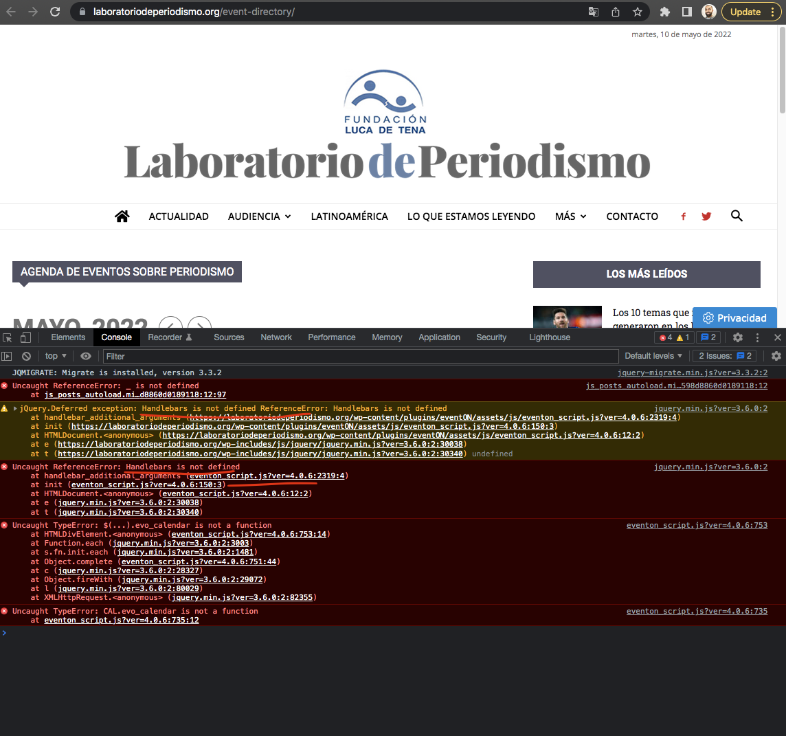

I’ve installed the Eventon Calendar plugin from Envato and it doesn’t work. Eventon support tells me this is a problem of the Newspaper theme, which blocks the handlebar script. Exactly, the Eventon developer says:
“the Newspaper theme is not letting the handlebar script run and eventON need this for it to run”. Here is a pic. https://helpdesk.ashanjay.com/wp-content/uploads/2022/05/Screen-Shot-2022-05-10-at-2.28.20-PM.png
The truth is that if I change Newspaper for another wordpress theme, the problem disappears
How can it be fixed?

Thanks for the reply. But you don’t really answer my question. I understand and it is understandable that you do not have to test this plugin, but that was not the question. The question is: does the Newspaper theme deliberately block handlebar script? Handlebar is not a script of that plugin, but a general script. That is the question, because the problem is with the Newspaper theme. When I switch to another theme, the problem disappears. The question, therefore, is: does the Newspaper theme deliberately block handlebar script?

The theme has many problems. The same thing is happening to me with other similar plugins like Stachethemes Event Calendar. The problem is the same: if you’re not logged in, you can’t see it. The plugin authors say the same as everyone else: that the tagdiv composer has a problem. Will you fix it please? I have more than ten websites working with your theme. Don’t we deserve a little attention?
