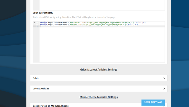

An update on this issue would be really helpful, thank you! I have tried adding the code here:
Settings

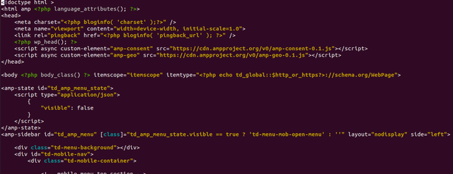

But it does not seem to show. I also tried adding it here (wp-content/plugins/td-composer/mobile/header-amp.php):
But it also does not work unfortunately. Any help would be appreciated!
