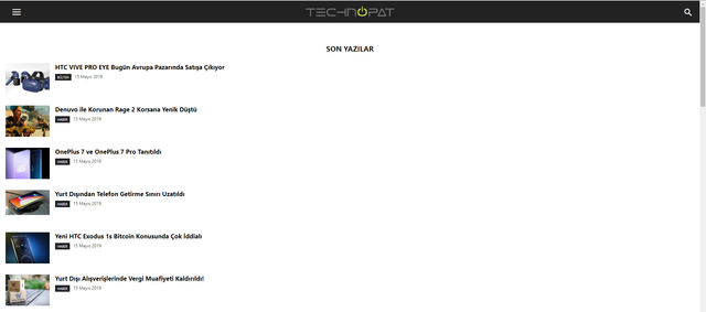

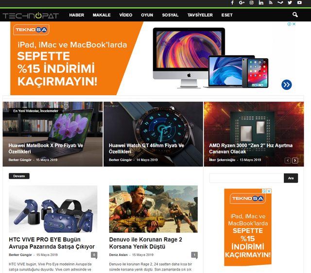

This usually happens because of caching plugins or settings from them. Some caching plugins can mix up the main theme with the mobile theme. We recommend where possible to use the super cache plugin, in our tests such issues did not happen when the mobile theme is active – https://tagdiv.com/wp-super-cache-plugin-install-and-configure/
If you use the same caching from this topic
– https://www.litespeedtech.com/support/forum/threads/issue-with-mobile-caching-in-lscache-plugin.17148/
You could check if the setting mentioned there is enabled, if not enable it and purge the cache. Check if that works.
Thanks
This is not with the case of litespeed plugin or litespeed cache, I have tested and get the same result on W3 Total Cache too. The problem occur when you have enabled object cache with the Mobile+AMP configuration turned ON. If you choose AMP instead of Mobile+AMP configuration this problem will not occur. Do note that you have to wait till your cache removed from your server.
