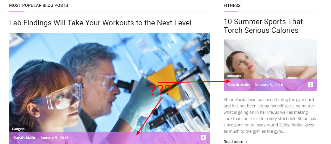

Hi there,
I do not know exactly the name of the this issue in terms of WordPress. But I add the picture so that it helps to find out. How can I change the gradient color which is behind the excerpts or title in the grids. Here is the picture of it.
https://i.hizliresim.com/0zVpv8.png
Thanks.

I see now what you are referring to, the color set for the post meta, for block 22 in the health blog demo
– https://demo.tagdiv.com/newspaper_blog_health/
By default that block looks like this
– https://demo.tagdiv.com/newspaper/block-22/
Bust most demos contain custom design for theme elements, that default color can only be changed with CSS.
A code lie this will allow you change that color for that block
– https://www.screencast.com/t/4sybDsWupra7
Use the color and opacity you want in the code, then enter it in Theme panel->Custom CSS (it will affect all blocks 22, unless made more specific)
.td_block_22 .td_module_17 .td-module-meta-holder {
background-color: rgba(185,60,44,.7);
Thanks
