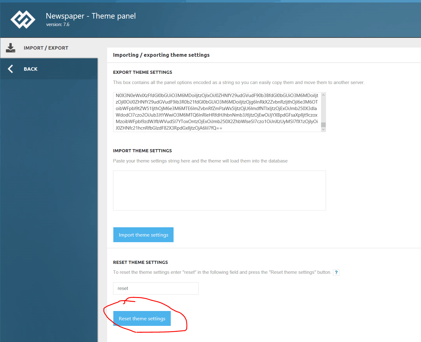

Thank you for the reply. How about the following option? If someone clicks on that button ..will this ask for theme activation ?
that button does not ask for the theme activation. It asks to type the word rest in the field above. Even though you already see the word rest in there, it has to be typed again. Here is an example:
http://screencast.com/t/ok2tY9S5PT If someone pressed this button, they did not need activation to rest your theme panel.
