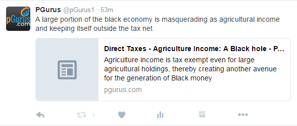

When I am attaching a URL link in a tweet, the graphic in that post is not getting picked up (See picture attached). I have the following in my Robots.txt for TwitterBot –
User-agent: Twitterbot
Allow: /*
I am using Newspaper V6.6.4, WP 4.5.1
Hello Mystic,
Unfortunately, we do not have any bad reports in this regard, sorry! I have tested on my side without any customizations and robots.txt and the twitter sharing work as properly. Also, I have shared a random post from your website to my twitter and seems to work as properly, as you can see here -> http://screencast.com/t/faG1vGx4
If your problem reappears, please try to disable the robots.txt configuration, clear all caches and disable all the untested plugins if you are using on your side and test it again. For more information about robots.txt, please check the documentation here -> https://dev.twitter.com/cards/getting-started#crawling
Thank you for your understanding!
Hi, i am having the same issues…
Cannot display images in the twitter card… my website is revistaladosis.com and i am using Yoast, having the same
Please help!
It looks that the problem is on the robots.txt
explained here http://www.cesarserna.com/fixed-twitter-card-images-on-wordpress/
