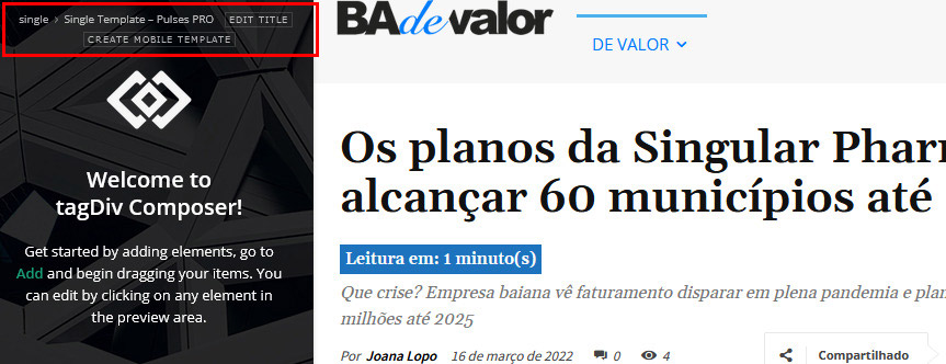

Can I have more than one template for posts using TagDiv Composer? Or just a one model?
Thanks Calin,
I managed to enable it using the indicated plugin. Just one more question. I can’t use TagDiv Composer on these old layouts right?
So in the standard post I can edit the top with these ADS and the sidebar, like this https://badevalor.com.br/ex-president-fhc-fratura-o-femur-ee-internado-em-sao -Paulo /. And in these old layouts, for example https://badevalor.com.br/retomada-hub-salvador-ja-opera-com-mais-de-100-empresas/ do I have to do it manually? Why widgets?
