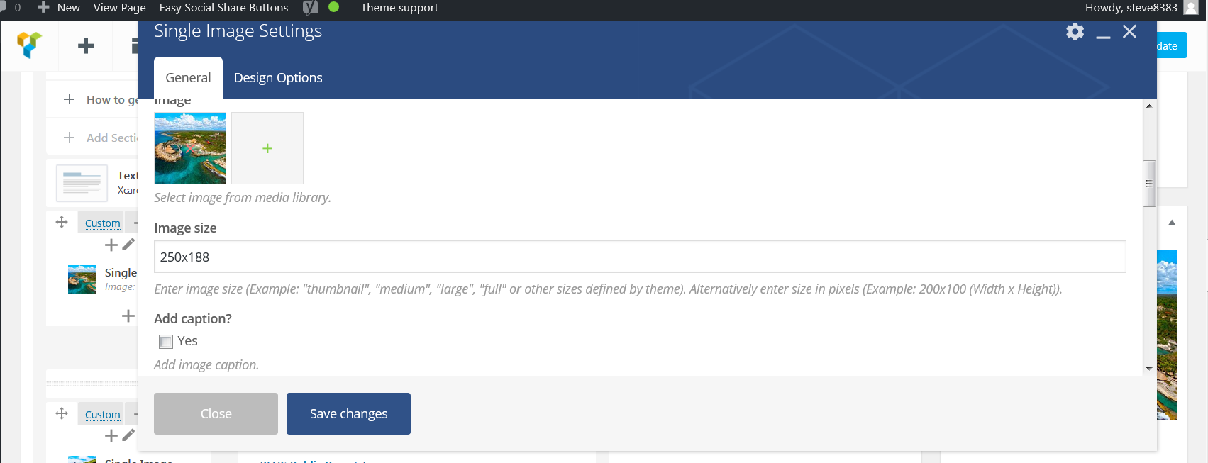

Some images are still rendering wrong. For example this page:
http://www.cancuncare.com/tours/xcaret-tours/
The images are supposed to be thumbnail size 250×188 and this is what is set in the single image setting (see screenshot http://www.cancuncare.com/screenshot.png). Yet the image displayed is a skyscraper shape.
Doesn’t matter how I change the single image setting, specifying size as above or defining it as ‘thumbnail’ or ‘medium’ the image always stays as this skyscraper shape.

Post count: 20688
Something is not functioning properly on your website. A theme reinstall and testing with only Visual composer enabled should fix the problem. Clear any caching installed as well.
The single images you mention seem to be created with the tagDiv composer, maybe you used both editors on the same page. That is strongly not recommended and can create these problems.
Try recreating the page in Visual composer, or create a similar page with single image elements and check if they display like that. Keep the tagDiv composer deactivated.
Layout issues like sidebar being displayed below main content are also caused by plugins or custom code, or modifications to the theme files directly or through a child theme maybe.
Thanks
