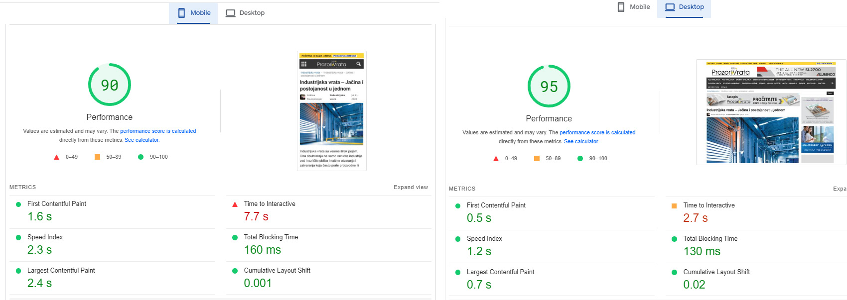

I managed to expand the width of the template to 1200px and on the first P+V website, I got 90 for mobile / 95 desktop on the google page speed test
Google page speed P+V
Although it is a huge website with over 20 google dfp banner positions.

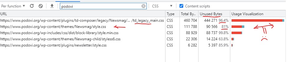

I had to modify your Newsmag/style.css and td-composer/legacy/Newsmag/assets/css/td_legacy_main.css a lot
there is still space for reduction and a better rating.

Basically, these two files must definitely be reduced, they are too big and too unused.
big css

this file is totally unnecessary.
It loads over 600Kb unnecessarily.
Most of that CSS is in the upper part of the site, which should be critical css.

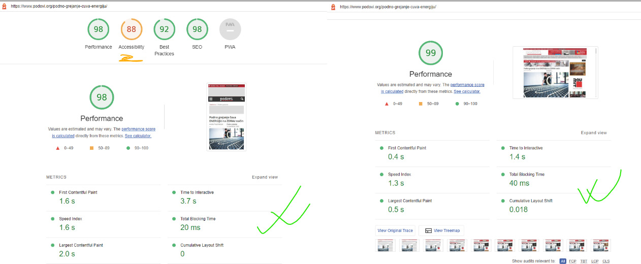

my new pagespeed result:
Podovi.org pagespeed test
