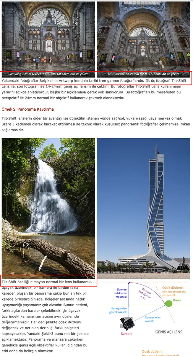

After the last updates (I don’t know in which update), the space between the paragraphs and the images and galleries in the articles has been reset. It stuck to the bottom line, as seen in this screen output. It wasn’t like this until a while ago, with at least 20px of space between them.
What should I do so that the space between is the same as before?

This is an issue; until this is solved, you can use the custom code css
.td-post-content figure img{
margin-bottom: 21px;
Set the code in Theme Panel -> Custom Code -> Custom CSS.

I added the code you sent to the “Theme Panel > Custom Code > Custom CSS” window and saved it. When I looked again, I saw that the lines I added were not saved. I had the same issue when I updated “Theme Panel > ADS” to add Google ads to our site.
We removed the “tagDiv Standard Pack” plugin because it puts extra load on our site and we don’t think it’s needed. According to the information I have read from several sources, this situation can occur without the “tagDiv Standard Pack”. Is this information correct? Do we need to activate the “tagDiv Standard Pack” plugin again for the code you sent to work as you suggest?

If the settings are not saved, please check this topic https://forum.tagdiv.com/topic/newspaper-theme-panel-settings-are-not-being-saved/

We are using LiteSpeed Cache plugin. Yes, in our LiteSpeed settings, as you mentioned, “Object Cache” was turned on. We turned this setting off, our problem was solved.
Thanks again for your help.
