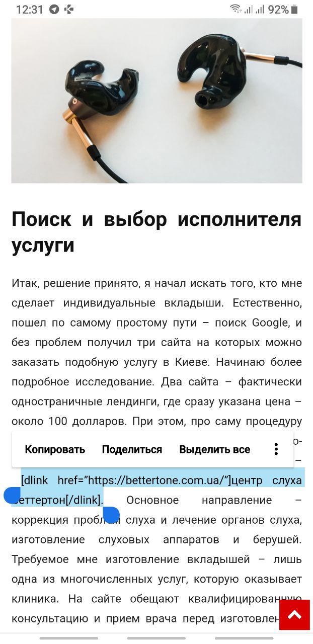

Yes, I tried to install the shortcode in the way shown in your screenshot – through a text-based code editor.
In the basic Newspaper theme (desktop and mobile responsive view), the shortcode works without problems.
I also want to note that other shortcodes (which do not contain quotes) work normally in tagDiv Mobile Theme.
The only problem is with the shortcode that contains quotes.
Have you tried to insert my shortcode in the tagDiv Mobile Theme for test? Maybe the problem is in the fonts that I use on the site?
Hi! I tried to insert a shortcode through a text editor, but it did not help. In the mobile theme, it is still displayed in plain text.
https://root-nation.com/wp-content/uploads/2019/02/photo_2019-02-20_12-33-15.jpg
As you can see, even on this forum, characters from a text editor are converted to quotes in published text :))
I also as you revealed incorrect quotes. then I read that this problem occurs more than once and depends on the wptextuarize function. And this replacement happens in the tagdiv mobile theme.
https://www.google.com/search?q=wptexturize+shortcode&rlz=1C1CHZL_enUA710UA710&oq=wptextuarize&aqs=chrome.4.69i57j0l5.4722j0j7&sourceid=chrome&ie=UTF-8
https://codex.wordpress.org/Plugin_API/Filter_Reference/no_texturize_shortcodes
