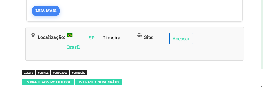

Another problem, I’ve already written and put icons, I tried everything in the screenshot, the icons appear higher and the text doesn’t stay aligned
https://i.postimg.cc/4yKhWvr6/Screenshot-1519.png

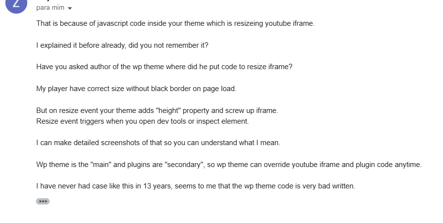

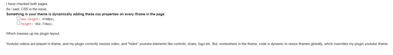

The plugin author sent me this, so you can analyze the error. Check out the following screenshots.
https://ibb.co/twH7xcrM
https://ibb.co/93k2JyFW
https://ibb.co/twp83mVK
https://ibb.co/MxczrG0b

In this case, the theme is pulling up, you don’t have to do anything. I’ve already uninstalled the theme and installed it from scratch. The error persists. I liked the theme, so I’m insisting on it. I need to solve the problem. This specific problem occurs on YouTube and in posts that have HTML.

For video problem try this custom css:
.Elite_video_player iframe{
height: revert-layer!important;
Set the code in the theme panel > custom code > custom css – https://i.imgur.com/xFgOaaP.png

Another problem I need to fix is ​​a default location description, the theme is pulling up the Brazilian flag and in just a simple HTML code, I need to fix this, watch the video.
https://app.screencast.com/mVrQYB1dKUNyG
from this post
https://glostv.com/radio/
I need a solution for this too.
Post count: 35449
For this https://i.imgur.com/jpdkHwn.png is normally use opacity 0 and a js should set it to 1 to create an animation, but it seems that for the plater you are using the js is not trigger, so the best option is to set the opacity to 1 using css
body.td-animation-stack-type0 .td-animation-stack .entry-thumb, body.td-animation-stack-type0 .post img:not(.woocommerce-product-gallery img):not(.rs-pzimg), body.td-animation-stack-type0 .td-animation-stack .td-lazy-img {
opacity: 1;
Set the css code in the theme panel > custom code > custom css
The location img has an bottom margin that needs to be adjusted https://i.imgur.com/zfzDehI.png this can be resolve using this css:
.location img {
margin-bottom: 1px;
