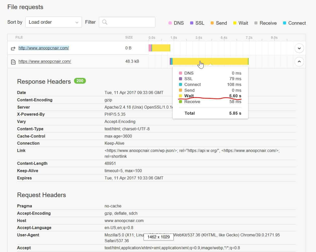

I have been working with Godaddy hosting (the linux virtual server provider) because of the issues of very slow loading time of the site.
I tested the loading time with different tools but it’s seems loading time is very high. Rather in the flow I could see that it’s wait for 5S/7s before loading the website. This is really slow
(see the attached pic
https://gtmetrix.com/reports/www.anoopcnair.com/3pyMLT7K (result is copied below)
https://tools.pingdom.com/#!/dtR5oa/www.anoopcnair.com
Godaddy says this is coding issue and the web developer says this is server issue but I’m stuck now . Any pointers would be really helpful !!

Thnx and I been provided with all these same links but no luck 🙁 I will check with the latest version of theme. Is there any automatic way to upgrade the Theme? All my custom setting will go away after theme upgrade? More over nobody is helping me to say what is happening at the second stage and why it’s waiting for 7s to get a response ?? Can you provide bit insides of this please?
Thank you much
I have the latest WordPress version installed. I never changed any code and one day suddently I got this issue and started seeing this delay.
I have inspected you website and it seems to load poorly indeed. From what I can tell the website is taking a lot of time loading the cache you are using – https://www.screencast.com/t/DxOwNzhYt7x and almost half a second for each image on the website. Adding those together results in the present situation.
